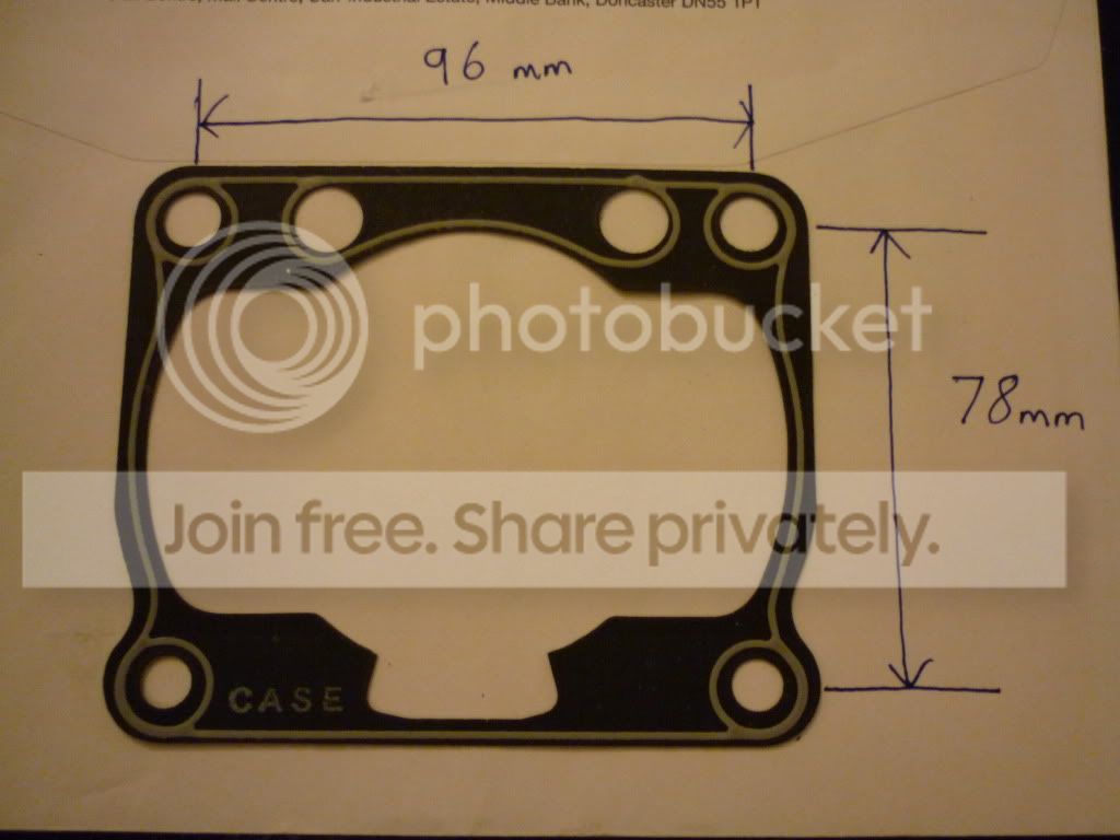

Neal
Is there any chance that this stud pattern may fit the 3xv ?
unofficial lap record holder --- to be corrected one day !
