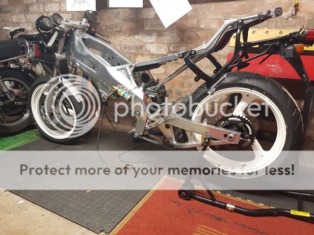

Some slow progress to report..
The original PV's were in a sorry state, held together with nails, one even looked as though it has been filed at some stage to reshape it.. I managed to acquire a set of decent barrels complete with PV's from a member on Fleabay. I'll get these parts off the the Aqua blaster shortly and get the top end compete - then I can get the engine re-mounted in the frame.

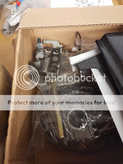

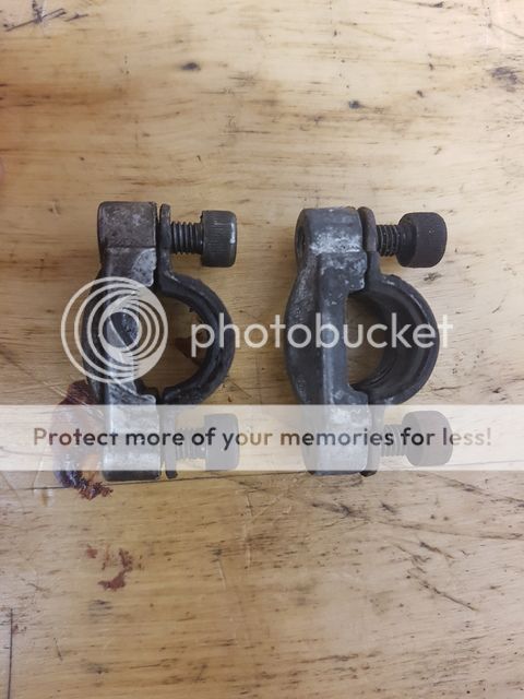

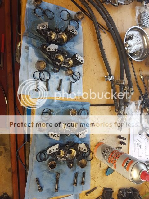

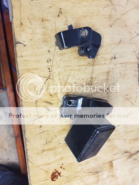

Managed to source a few more parts which were beyond repair, thanks again to members on here and also from Ebay..
PV linking bracket
Calipers stripped and cleaned, to be painted and rebuilt with new seals
Engine mounts in place
Dropping this lot off to F&J Vapour Blasting today
Carbs - to be ultrasonically cleaned
Brake master cylinder
Clutch level bracket
Horn bracket
Rear brake fluid tank bracket
Rear caliper anti rotation bracket
2 X barrels with PV assemblies
And a few other little bits & pieces

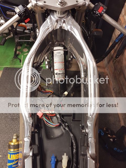

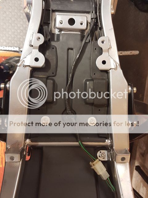

I've also managed to get the headstock/clocks wiring in order as per the service manual, and have fitted the rear pegs etc..
That's about all for now - more to follow!

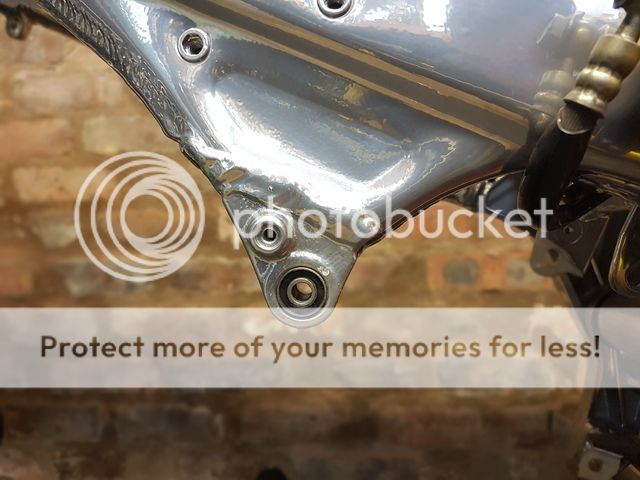

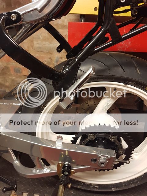

A guy near Southport (http://www.apowdercoating.co.uk/)
To be honest the finish on the alloy in the shiny silver colour is not the best & he somehow managed to "misplace" half of my rear caliper and one of my rear foot pegs..
To put it mildly I was pissed, managed to get a heavy discount so the majority of the powdering work cost a small amount. The finish looks like polished alloy, or what you would see on old school American cars with chrome rims.
I'm not sure of the exact colour as when I arrived he showed me some previous work in that colour and I just agreed. It's quite a thick coat and the frame number is now a little hard to read (hopefully it will be OK for the MOT). Also they didn't mask hardly any of the holes in the frame so I've spent hours sanding/filing/reaming.
Since my experience with the above I've used a place in called Triple S (http://www.triple-s.co.uk/) near Huddersfield. Much, much better quality and amazingly they haven't lost any parts as of yet.
Moral of the story - use a company with a good reputation..
