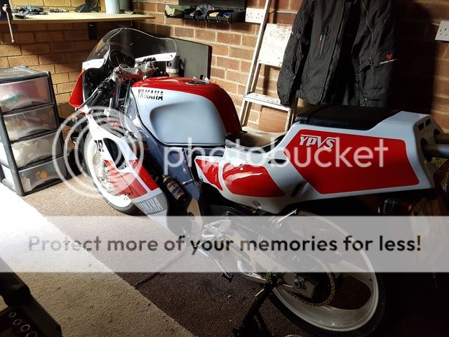

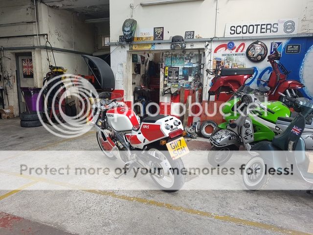

@theophilos13 - I wish I knew the carb was missing the part...  ?:-| ?:-| ?:-| Anyhow, it's sorted now..
@Paul8899 - The stand switch functions OK, Coil was duff, got one from Fleabay and she's sorted for spark
Thanks all for the assistance with help on here.
I set off from home this morning and she's now got Tax & test! It hasn't seen an MOT station since 1993!
She is running good, as good as to be expected. Flat spot around 7k but below and above plus very clean.
I got a little issue with hanging idle which I think it an air leak which would make it run lean, temp rose to just under 1/2 in traffic and stays on about 1/3 on the open road. It's hard to believe that it's almost done (apart from the mirrors, which are on route).

Well it's been a while since I've posted on here, bike is now 100% ready to ride!
Box oil is no longer mixing with coolant, various bodywork fixings replaced for period fasteners, mirrors fitted!, de-restricted (snorkles cut, exhaust rings removed and jetted to suit), leaking fuel filter sorted, some cable routing altered..
The bike is finally ready for the summer.. for anyone that seen it, I'm amazing it ran okay for the duration of the mag shoot (which was the day it was MOT'd)..
Anyhow, she is ready to be used and abused ????
