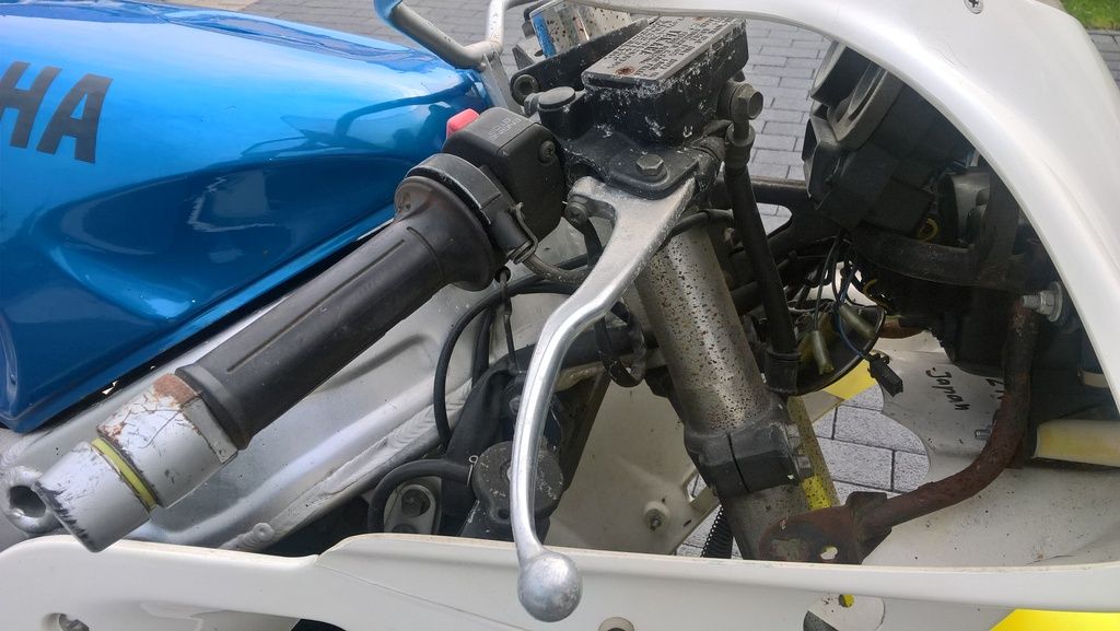

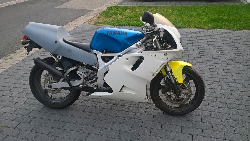

So I have started a new project, I bought a used 4FL. I got that cheap, of course it needs a new heart (engine is broken), some renovation of her clothes (the seat is a racing one without cutout for the taillight, the fairing V-piece is missing, etc.) and a new makeup (no paint job at all).
I will take her apart, get the frame and swing arm painted and will put everything together. To get the TÜV approval I will use the engine of an other 4FL I have (will be sold after that) and then start to build the engine taking a 3XV barrel and a new pipe.
I have a R model stock fork which I will take and will convert the electric system with a available 3XV loom (no E-starter any more...)

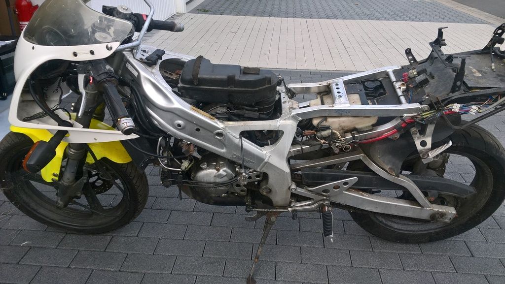

I took the bike apart on the weekend and found one strange thing with the ignition key mounting... There are no bolts like on my 3XV or RZ, only this kind of clamps.
So has someone a good idea how I can remove them or cut that back to take the things apart?

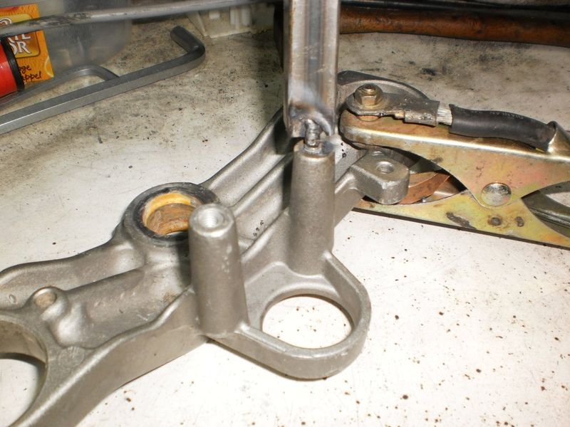

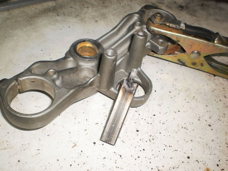

You can also use an arc welder.
The heat will destroy the loctite if any and the metal dilation steel vs alloy will make the unbolting more easy.
If the can stick the welding rod on the bolt then you could unscrew it.
I'll not be as it was for me.
