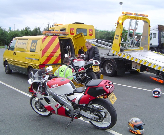

Oh really ?  So which bike do you see on the back of the AA truck then ?  :D  :D  :D
Talk about 'kiss of death' - ha ha !

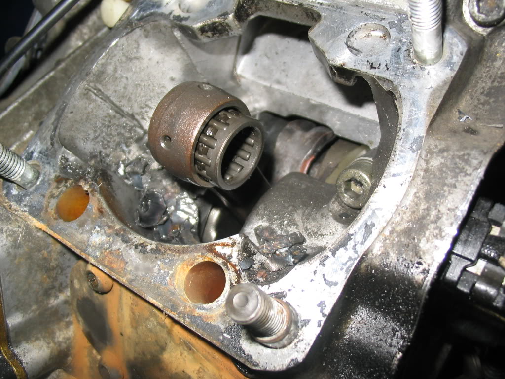

When I bought it there was a mis-fire, later diagnosed as a piece of missing piston ring, part of the crown also missing, and a very battered head.  I cleaned up the cylinder, had the head re-shaped and skimmed, fitted a new piston, rings, gudgeon pin and clips and it was as right as rain. It's done about 400 miles since the rebuild.  It still had that odd vibration above 90 (on private roads), thought to be wheel balance.
It dropped on to one cylinder as we joined the M1, but it's done that before and cleared. As we approaced the M18 exit, it lost power, I dipped the clutch, and it was still running so I let it out again.  It seized solid and locked the back wheel.
I pulled it apart last night. It's the re-built side that's failed. Not the piston, and not a broken ring, but the big end bearing. The cases are full of broken bits of roller cage and "metal flakes", well now we know what the vibration was. It has of course blown some of the bits through the transfer ports, and had a good go at the piston, bore and the power valve. My re-faced head will need doing again aswell.
So that's a winter job then.
Does this mean Warwick owes me a fiver...? I could do with the cas towards the cost of a crank re-build.

Erm, well... In view of the probability that the initial big end damage (and source of vibration which preceeded the seizure) was caused by the original piston damage - which shows all the hallmarks of a ring pin failure, I would argue that my wallet should remain unmolested for the time being :D
Sorry to hear it was big one. On the bright side you will have a completely refreshed motor when it's done.

Bet the bottom end looked like this...  I've Been There !!!

I haven't actually seen what the inside of crankcases looks like on my bike yet, the engine's still in the frame so it's kind of difficult to see inside the left cylinder...  But the pieces of cage and roller I pulled out when I took the barrel and head off look exactly like the bits in yours.

I've just noticed there's another dead 3XV crank, big end failue, on eBay in the USA.
Seems they're the same the world over, I'll fix it, one day.
