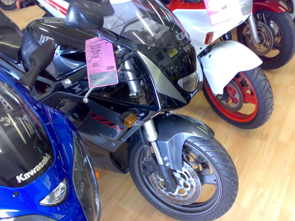

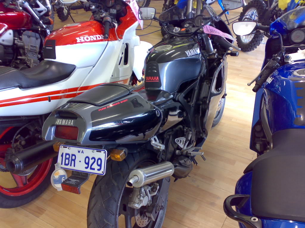

Here's the girl!

Looks like a nice stock 91 R model - you'd maybe want to change those tyres though ???
If my experince is anything to go by, you should be able to achieve high 50's with some decent pipes and the barrels ported to SP barrel spec - or 'tuned' by someone who knows what they're doing just using the stock -00 ignition.
The only way I could get past 60 at the wheel was then to use a Sugo race kit ignition, but there may be other ways. The stock loom is fine and the carbs etc. seem good enough to get comfortably into the low to mid 60's.
It is deceptive though, I've had (or still have) just about all of the race rep 250's and I'd take even a stock 3XV over any of them - and, on the road, I'd swear that journeys are quicker and more enjoyble on the 3XV than any of the others too. Just my personal opinion of course, but you've alredy noted how good the 3XV feels in the 'real world'. It would also surprise you (and the riders of more powerful bikes) on the track too (even in stock condition) if my experience is anything to go by.
In short, if you can get it for a good price, I'd very highly recommend it. You can work on the power over time, but for the time being you could just enjoy the great ride.

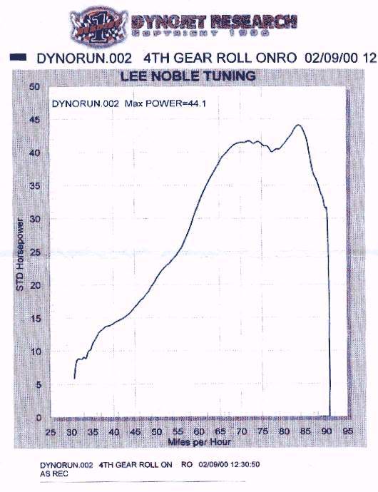

A fit 3XV should be good for close 45Bhp at the wheel I think Jools. Here's mine in totally stock set-up when I'd not had it long:
Kind of arbitrary really I suppose, but mine always had the little kick at the top of the curve. Other stock dynos I've seen vary. Some have it and some don't? No idea why though. Yet another 3XV mystery I suppose, lol.

Just check the tank for rust. This gets into the carb filters and blocks them provided they are still there. If they are missing it will lead to problematic carb flooding.
Thats about the only fault with these bikes. Keep the front brakes serviced as they can bind if left.
And of course a good set of tyres.
But replace those pipes they stifle the motor and weigh a ton.
I got a set of Bossons from South Africa delivered for just over $A600, very light and perform very well.
Otherwise there are used Jackals & Dog Fighters on the Japanese auction sites for around $US300 plus freight.
You could also fit TZ pipes but these require a bit more work and manufacture of suitable headers to make them fit.
