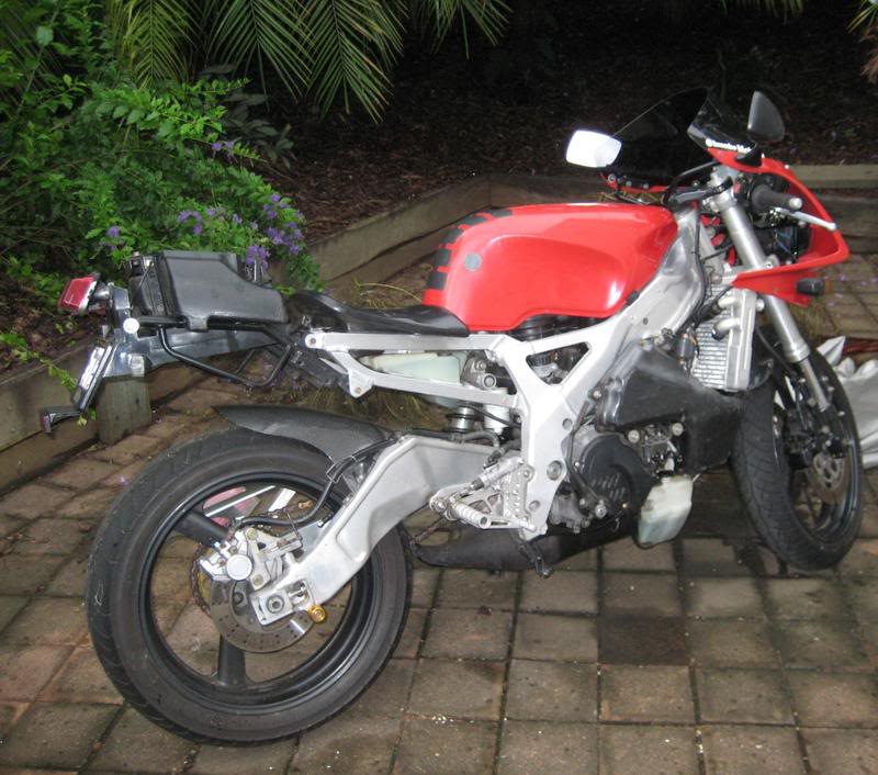

its hard to see but there was a lot of oil running down the closest exhaust to the back wheel.
and how could i not post a picture of a naked 3XV!!
