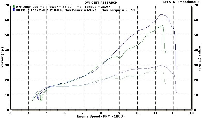

Whaaaaaaaaaaaat?!
Surely you're having a laugh now?! Even a stock MC18 wipes the floor with a 3XV in the midrange! If your 18 didn't work, then I'm not trying to insult you, but it wasn't set up correctly. TYGA pipes on an MC18 put about 2hp on the top-end, but wipe out about 8hp from the middle... bringing the mid back down closer to the lesser 250's!
The blue trace is a stock MC18, the red trace is the same bike with a soldered wire, and the green trace is the 3XV with ported barrels, skimmed heads, ported cases, modified airbox, race pipes, race CDI, etc.
I knew that I couldn't try to constructively add to a thread without someone trying to assassinate me and/or the NSR. I thought long and hard how to air my observations without turning it into a "mine's better than yours" thread, but it doesn't seem to matter how you word anything does it?
Warwick, you are living in a dream world! I respect the fact you love your 3XV, as much as I love my NSR's, and I admire your perseverence, but how you can compare the level of work required to make the bikes perform how they BOTH should is totally unrealistic! At the end of the day I can have a stock Honda making 60hp within 10 minutes.
You are turning RGV on me now though... insults of crap gearboxes and aggricultural motors are more akin of the rubbish you would expect to hear elsewhere from people stuck in the "official import/full power UK model" bubble! You'll be calling the NSR "gay" next! ???
We certainly slurp the 2T, that's for sure, but how you can call a motor that shares its design with a GP bike that won 5 out of 6 WGP championships in its' life-span aggricultural, amuses me. If we are trading questions, which I prefer to insults, why on earth does the Yamaha nead a balance shaft? Unless it's a flawed design, a 90° V-twin should naturally be in balance.
