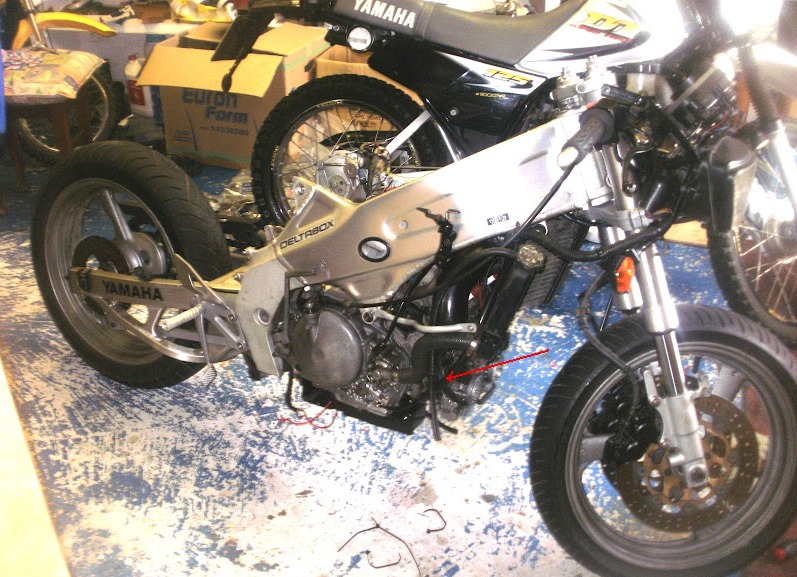

Postby Louis » Mon Apr 30, 2012 10:08 am
Hello Luke,
Looking to your picture and spotted (if I'm right) the long hose that goes to the R reed rubber then to the L reed rubber.
If that is right, you can ditch that by swaping the reed rubbers from L to R and use one of the alu tubes to connect them.
Most of the 3ma riders ride like that.

Postby Luke 3MA » Mon Apr 30, 2012 12:33 pm
Ha Ha Louis well spoted. That is actually my water overflow tube for the moment whilst I don't have a water tank( I think that's what your pointing to) But yes I will do that. My 3ma3 reed rubbers have a joining bit in the middle will check that out.
