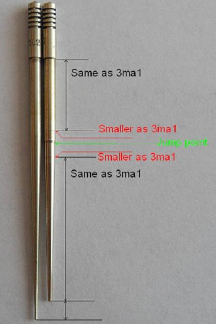

That funny middle bit makes sense to me. Its almost got parallel walls which will make it leaner from idle to say 1/2 throttle looking at it. It looks like yamahas answer to the rich midrange that 3ma's can suffer.
Do you see what i mean louis?

Yes, that is what I thought to.
But the dimensions of the needle are the same (what I can measure) only the middle section is different.
Looking from top to bottom.
-First part 3ma3 needle is the same as a 3ma1 needle
-Then (red section) 3ma3 needle its smaller compare to the 3ma1 needle (with section I mean from red line to jump (green) point)
-Then (green) 3ma3 needle is the jump section
-Then (red section) 3ma3 needle is smaller compare to the 3ma1 needle (with section I mean from red line to jump (green) point)
-Then the 3ma3 is the same as the 3ma1 only the 3ma1 needle goes further (longer)

Very informative Louis! Cheers

I never really looked at it but there is almost no difference between the needles accept for that tiny section in the middle which will only effect a very small portion of the throttle position.
It seems pointless putting a 3ma3 needle in my 3ma1 then because all it will be doing is affecting a very small bit of the throttle range, where my bike is rich from 5500rpm-7000rpm at all throttle positions so logically the needle might help to get the bike past that rich point but only at a certain throttle position and not all throttle positions.
I will still try the 3ma3 needle to see what happens.
