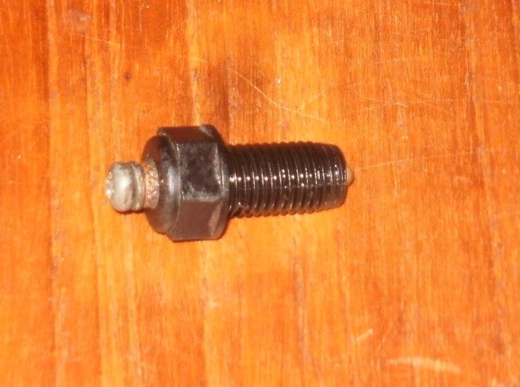

Postby Luke 3MA » Sun Apr 15, 2012 5:00 pm
Is this the neutral switch?
It was not connected and hasn't been even when I rode the bike. the wire coming from it is a dark blue which is a one pin male. there is a light blue wire coming from the neutral light which has been cut off. this is the reason my neutral light has not been working isn't it. they should be connected to each other but the dark blue wire must be after market.
Luke 3MA
Posts: 185
Joined: Sun Mar 18, 2012 8:52 am
Location: CT South Africa
Re: 3ma1 performance tuning
Postby Luke 3MA » Sun Apr 15, 2012 5:11 pm
No need to answer my question, I connected them and whala neutral light behaving as it should. So it seems the only thing left is the CDI, which I have tried to test but got nothing although I am not sure that I am testing correctly. and I also have to buy a 3/4 or 1/2 drive to a drill converter so I can spin the stator at a greater power without it slipping in the drill.
Postby Louis » Sun Apr 15, 2012 8:28 pm
after I fiddled with the neutral light and got it working I decided to check for a spark just to see and I did see a spark
Great luke that you have found it ;) , was it the neutral switch?? or the fiddling with the wires??
