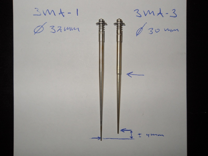

If I understand you right you have the 3MA3 carbs with 3MA1 Needles and 3MA3 Needle jets. Needles in middle clip. 200 mains 0,92mm airjet
Then I fully agree with you, don't think the carbs will be the problem.
Perhaps a silly question, but how does your pv turn? (You might have switched the cables, and they are closed by 8500rpm)

Isn't the 3ma3 needle way too long for a 3ma1 carb too? Won't it almost still be in the needle jet at full throttle?
Dan
maccas
Posts: 125
Joined: Sun Mar 18, 2012 10:42 am
Re: 3ma1 performance tuning
Postby Louis » Sun Apr 22, 2012 10:08 am
Hi Dan,
The 3ma3 needle is shorter than the 3ma1 needle.
Think if you leaf the clip from a 3ma1 needle it in middle position in a 3ma3 carb. It should be more/less the same as a 3ma3 needle clip in lowest position.
Only you don't have the (strange) middle section.
I fully agree with you if you put a 3ma1 needle with the needle clip in leanest position in a 3ma3 carb it is prety lean.
Hmmm just thinking of something right now, would the slides be different? Between the 3ma1 and 3ma3 carbs?

Sorry louis i meant the other way around, 3ma1 needle in 3ma3 carb
