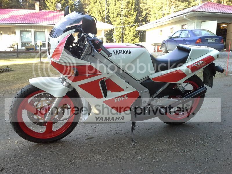

So we met there and I tested the bike. I was sold. Bike felt fantastic. It was also in quite good condition, some scraches here and there, but it ran nicely. So I bought it. Here is some pics after I arrived back home:
In the background there is my '86 RD125 YPVS "Micron Spec"
So then I was proud 250 owner. I rode with it approx 1000km's before winter and I really enjoyed every of them.
