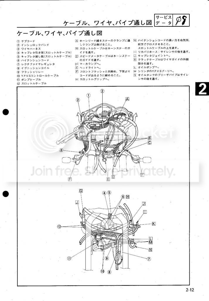

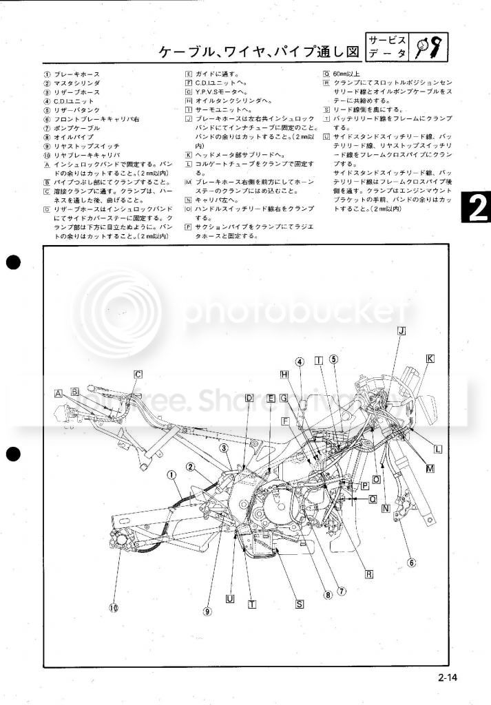

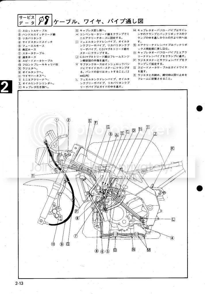

I will be seeking out all of your brilliant photos to try to work out routing of cables pipes etc over the coming weeks

Now onto the wiring / cables/ pipes etc. All photos showing routing of said items greatly received  :-\

There is alot of pics scattered around the interweb that you could look at for the cable routing, but I found pages 53-55 (section 2, 12-14) of the 3MA1 ws manual very helpfull doing mine
