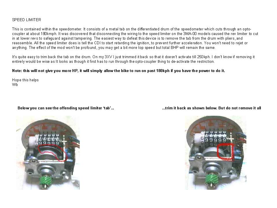

@Neilj Here is the ancient thread :
https://pure2strokespirit.net/archive1/localhost/cgi-bin/ikonboard88d3.html?s=cc546999de3446d361d9dd7b0f95594a;act=ST;f=5;t=129
And the pic in question :)
I would probably skip modifying the speedo to be honest. A stock 3xv doesn't really have enough hp to make it to 180kph. You're better off with a Zeeltronic or Sugo CDI which ignores the restriction.
