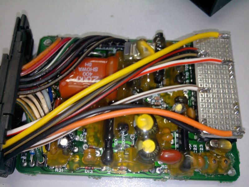

TESTS
Battery power was very BIG consumption due to YPVS motor
To be checked : motor off is maybe 0v on both pin ?
;D
After a small hack on the new loom, the bike starts like with the OEM CDI
Test 1 = with 12V power supply from ATX PC Power supply  :)
Test 2 = without battery only a battery eliminator  :D
Download the video and play it  ;D
ICP12 powered => Green led blink
Video_ICP12_01.mp4
Bike stars => red led blinks when ignition is trigged  ;D ;D
Video_ICP12_02.mp4

Edited my previous message.
Will check too the OEM IC on the YPVS pin 5 and 6
I found the pin 7 and 8 are also involved in YPVS driving  :o
Pin 5 and 8 work together
Pin 6 and 7 work together
Pin 5 and 6 work in opposition
Olivier.
TZR250 2MA & 2XT, RD500s et TZR-V4 building...
tzr-v4
This is confirmed :
- pin 5 and 8 work together
- pin 6 and 7 work together
Soldered on the IC emulator the pins together.
I powered the CDI and the ICP12 and :
- no more heat building the the STA434A IC (double H-Bridge)
- ICP12 fully powered
- neutral light very bright
- oil light bright too.
Tomorrow I hope to test YPVS operating  ;)
