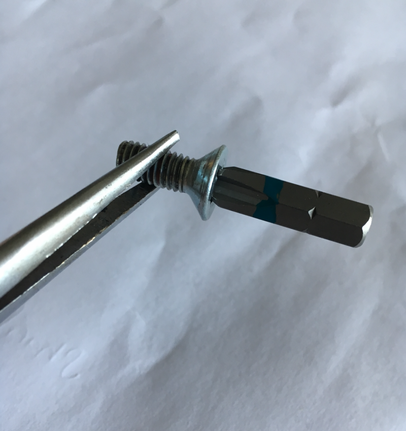

Those screws can be a pain, I have destroyed a few with my ignorance :(  :-[ Now I attack them with a proper JIS bit:
They fit those screws real snug:
Then heat it up with a torch and use a socket wrench with suitable attachments to get it out (-P) The added advantage is you can properly torque (8NM) them as well with the wrench on reassembly. If you don't have a proper JIS bit then often you can find a bit in those cheap toolsets for electric screwdrivers that fit better than your average philips.. Failing that you can even file down the tip of a normal philips bit which will give a better 'bite'.

ybk - Thanks for the insight, Karl. I feel a bit foolish in not knowing that those two screws were anchored with Red Locktite (which requires heat). I'm not sure of the brand of the #3 Phillips the "tool shop guy" gave me to try, but once seated, it did not "cam-out". In fact, that screw holding the counter-shaft bearing was pretty buggered up (by me). Glad it all came apart, but I'm wondering if I can find a hex-head or torx-head version of these screws. It certainly would make things easier, assuming I dig this deep again on this specific bike.

Quote from: Steveog on February 08, 2019, 07:10:48 PM
Strangely enough when I ordered those screws from yamaha I received ones with a torx head! Then second time round I got the philips heads again. Luck of the draw?

Steve,
I'm not sure how easy it is to get metric fasteners in USA, but I usually replace all JIS/Phillips head screws with high-tensile Allen socket screws. Most of these are available ready-zinc-plated for 'external' fittings. As far as countersunk (and also the rounded button-head) M6 Allen socket screws go, beware that these may only be good for use (i.e. installing and removing) a couple of times - the hex sockets can 'round out' if tightening torque is high. I use blue Loctite on these rather than the red stuff, which lessens the chance of damage on removal and heat is rarely required. The screws are cheap enough, so I usually buy 20 or more of each size, just to make sure I always have replacements ready.
If you do end up going for the Torx socket screws, please let us know your impressions!
Steveog
Hi James. Thanks for your contribution. Many of our cars are now built with metric fasteners. Even modern Harleys are partially metric. A couple are more than half metric. This 3xv is tricky enough, imagine juggling two types of measurements and wrenches.
Lots of metric tools and fasteners here. In fact, I replaced the phillips screws holding the oil filter with hex-heads of the same length. Used blue locktite after tidying up the mounting holes with carb cleaner.
I like the idea of a torx-head for a the counter-sunk bolts holding the bearings in place. Seems that more, if smaller contact points would mean less possible damage upon removal. I have no science to back that up, just a feeling. Your point about limited duty cycles for any fastener is worthy of note, however.
