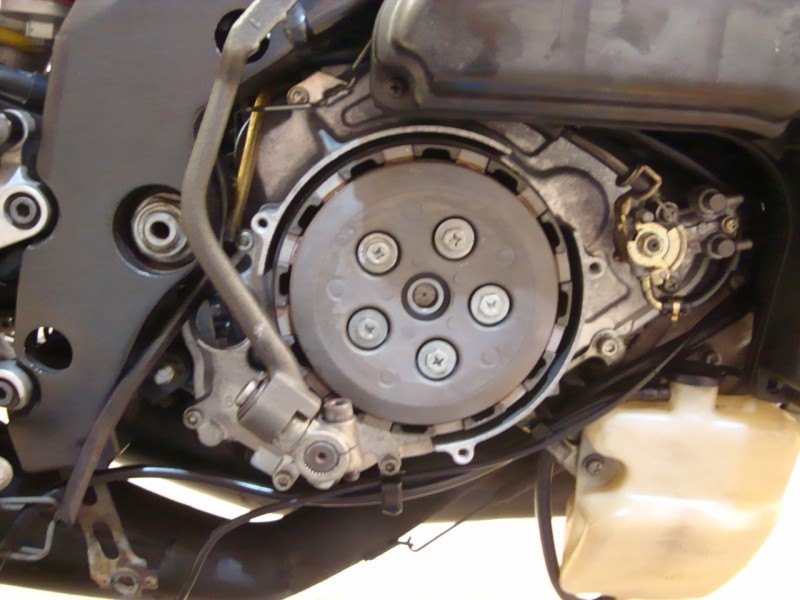

The plating around the exhaust ports looks like it's worn down to the point of needing a replate. The coloring in the picture it looks lighter than the rest of the cylinder wall that doesn't look as worn down.
busa1300
It will get all new bottom and top end when I pull it all apart for its rebuild. And I will get cylinders sent out as well.
Just trying to get it running now as a complete bike, so I can get a quick feel for it before the snow finds its way here. I have another bike that I was planning on doing a full rebuild on first, but I didn't want the 3XV2 just sitting and not able to be run....needed to see what it needed before throwing more $$$ at it.

You didn't ask, but I highly recommend Powerseal In Pennsylvania. They did my cylinders. One of them twice. Precision work. Not as expensive as others. 10 day turnaround. A bit less than $400 USD for both cylinders (plating, honing and port chamfering).
Rick may be right, but try to get a bounce light under the cylinder for better imaging and more help from the Forum. What's a bounce light? A solid white surface that reflects a direct light from under the cylinder, giving a softer, more even light helping to analyze the honing grooves.
Of course, you've been down this road and can make your own qualified judgements, but getting help from the experts here sometimes requires more attention to the photography. (Lesson learned by error, error and trial). Your cylinders may be just fine as they are. Good to have back-up opinions, though...some from using and modding these bikes for almost 15 years.
That photography opinion is not directed specifically at you, Busa. Just an opinion from one with a 50 year career in photo/videography. That said, "You've done a great job documenting your build."

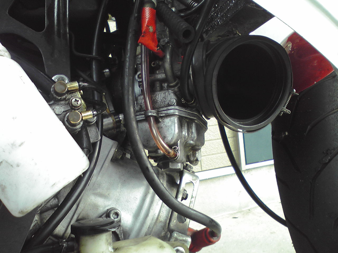

If the SPR upper air-box allows more air flow, do you plan to open up the manifold boots, too. Maybe, I don't understand the SPR mod.
Steve
Brief, fleeting Glory. Which of itself cannot last, but while it does is the best game of all.
busa1300
Here is a SPR airbox intake.... just one huge hole compared to the SP version....box itself are the same I believe.
not my bike.....from a Japanese blog
