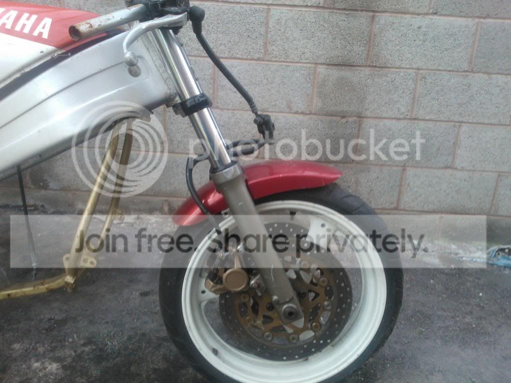

Here is this years project..  I have always liked metric cruisers.... But I don't like the HD wanna-Bs.  ErrrRrr of course I like the R6 at the showroom here...  I don't like payments however...  But...  (you get the idea)

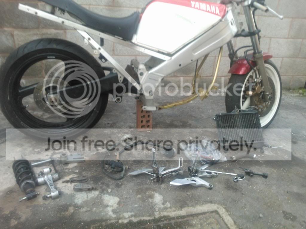

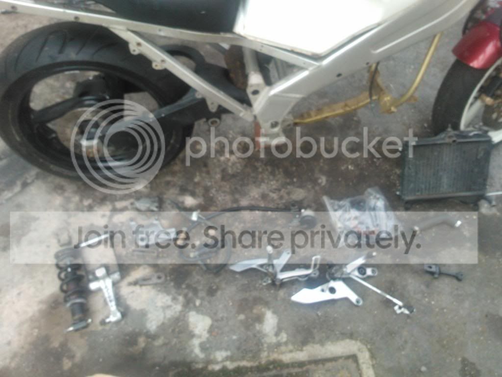

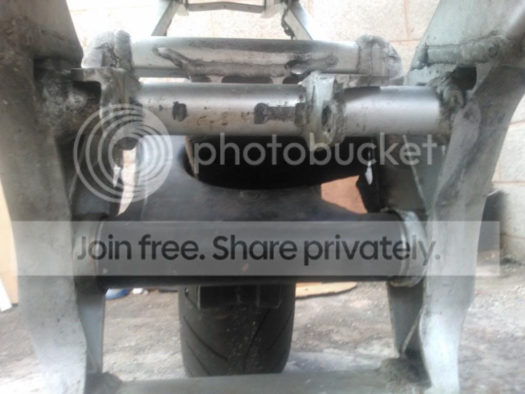

Doesn't look to bad... but.. Rotten exhaust, cracked bits in frame, missing oem parts uhh!

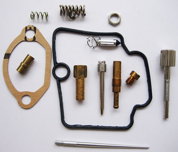

Shrunken carb joiners.. replaced
Frame to weld
Parts paint striped and tumbled
